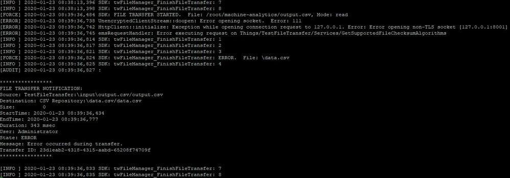

There was a little problem.
I had to specify the port for auto_bind device in config.json and the problem has been solved.
