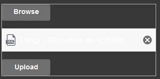

I have the following file upload widget and i want to edit the background of the uploaded file part.
I have tried using the custom css  and setting list-item in the customClass property
.list-item::part(file-item) {
 background:#383838;
 following the ptc documentation I tried also this
@supports (ptcs-style-unit: "PTCS-FILEUPLOAD") {
 [part=file-item] {
	background-color: #383838;
but all my test failed to edit the style of that part

We would like to know which area you would like to change the BK color, a demo mashup might be helpful.
Nov 28, 2024 9:15 AM UTC
The thingworx version is 9.6.0
The area that I want to change the background is the one that opens after I selected a file. The area that has the white background in the screen in the original question.

can you try below code?
@supports(ptcs-style-unit:"PTCS-FILE-UPLOAD-LIST-ITEM"){
   [part~=file-item] {
       background: red;
