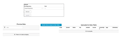

FileUpload Widget - Verify data before Uploading

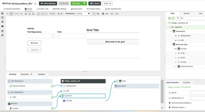

Mashup contains - FileUploadWidget and a Grid Widget

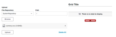

When I select a csv file (currency.csv) then before uploading that csv I want to view that in the right side grid.
Datashape Contains- Code, Name, Symbol
nmutterAnswer

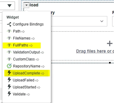

Regarding your bindings (with first upload to repo):
- You should only call "LoadCSV" service on "UploadComplete" event of the upload widget (not on Mashup Load event).
- as 'path' you should bind "FullPaths" property of the upload widget (will only work if you upload a single file (otherwise the property will have path1|path2|path3 - separated by |)

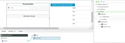

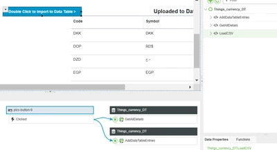

We want to preview the csv data before inserting the data into the data table.
Steps :
1.. Pre-requisite -> CSV Parser Extension Imported (You can get if from - https://iqnox.com/thingworx-widget-development/ )
2. Firstly you should know your data  - Make data shape accordingly.
3. Make a data table

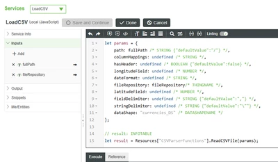

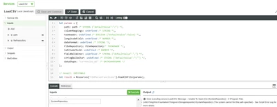

4. Write a service, suppose service name - "LoadCSV" to load the data.
a. Snippets ->  Resources -> ReadCSVFile to get Javascript snippet. Make the changes accordingly shown in the screenshot.

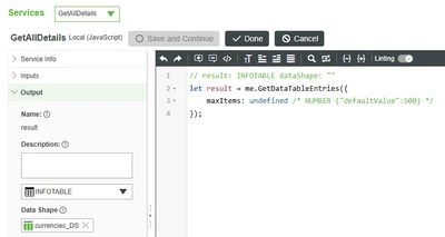

b. Make another service to get data entries
Me/Entities -> services -> GetDataTableEntries

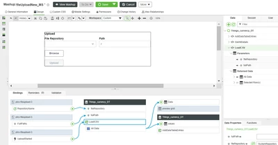

5. In Mashup -
FileUpload Widget,
Grid1 (for preview),
Button (if we click, data should be added to data table and to Display the data into the grid)
Grid2 (to display the data table content)

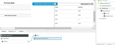

6. Bindings
a. File Upload Widget
 2. Preview
 3. Button
(Note: Doble click the button - First the data is been added to the data table then we can get the data elements in the grid)
4. Uploaded to Data Table Grid
