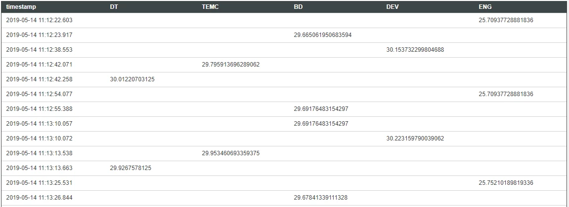

I have a infotable with some columns (timestamp, DT, TEMC, etc;) and values are some null and double.
I need to replace the null with previous value. If previous value is also null, then I need to replace with next not null value. Please help me out.
Find attachment for my infotable

    Please keep in mind that null is different from undefined
    You either just loop through it and check each value and replace it,
    Or you could use derive fields to generate a new column
    if they are null you can use the following in the expression
    columnname ? columnname : "nullreplacementvalue"
     but that can't get you previous value unfortunately.
