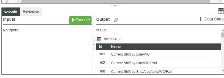

I am using get rest api call and fetching a set of Id and Name. I wanted to pass an argument or filter using the Id field and fetch the data for that respective id alone. How can I acheive this in thingworx javascript? I have mentioned my get service below.

I have attached my output for this get api in which I want to filter w.r.t Id column.

There isn't a way to combine it with Query, but if you look in the InfoTableFunctions you'll find Distinct as a service as well.
22-Sapphire I
You can do an additional Query on the infotable using the InfoTable functions
Here are all the queries that you can use.
http://support.ptc.com/help/thingworx_hc/thingworx_8_hc/en/index.html#page/ThingWorx%2FHelp%2FComposer%2FThings%2FThingServices%2FQueryParameterforQueryServices.html
Hi @PaiChung,
Thanks for your swift response. I tried using LIKE operation from the link and it worked for me. Is there any query to fetch only distinct values from get rest api call. For eg: I want to fetch only distinct column 'Name'.
