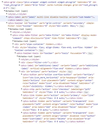

If a user should not have access to running some service where you for example add/delete/update a row using the Edit button of the grid. I have not found a good way of preventing the user from actually clicking the Edit button in the grid as the "EditButton" property of the grid widget is not bindable:
Now, I was able to make the button disabled by using custom CSS, but to make that work I had to disable the entire grid toolbar using this custom CSS code:
.myGridClass .widget-ptcsgrid::part(grid-control) {
pointer-events:none;
But by doing this, I also disable the "ColumnsMenuOption" that shows as "Display" dropdown in the grid toolbar.
Does anyone know how to (if possible) disable just the Edit button?

I think it helps a little bit although I am not sure how for example this:
https://www.ptc.com/en/support/article/CS314561
Helps with the newer grids and how to use it.
One thing in this support article for example:
.myGridClass .widget-dhxgrid .gridbox table.obj td div {
 text-transform:uppercase;
 text-align: center;
This .widget-dhxgrid is understandable, it's the same as .widget-ptcsgrid that I use in 9.3.
But, the .gridbox I don't quite understand how it's being used here?
Could I do the same thing in the new grid? Something like this?
.myGridClass .widget-ptcsgrid .toolbar::part(button) {
I don't really get kind of the hierarchy of this. So if anyone knows if this is even possible or how to do it I'd very much appreciate a small code snippet.
