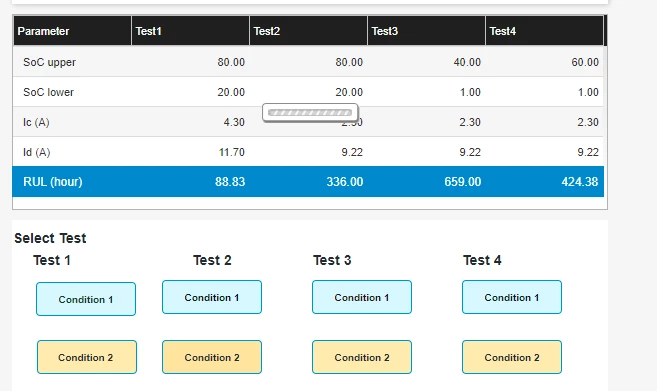

Can anyone help me with this flickering symbol appearing on my grid widget. This symbol appeared after I binded the serviceinvokeCompleted event to GetProperties.

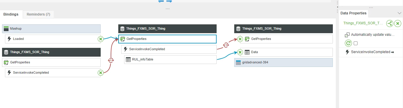

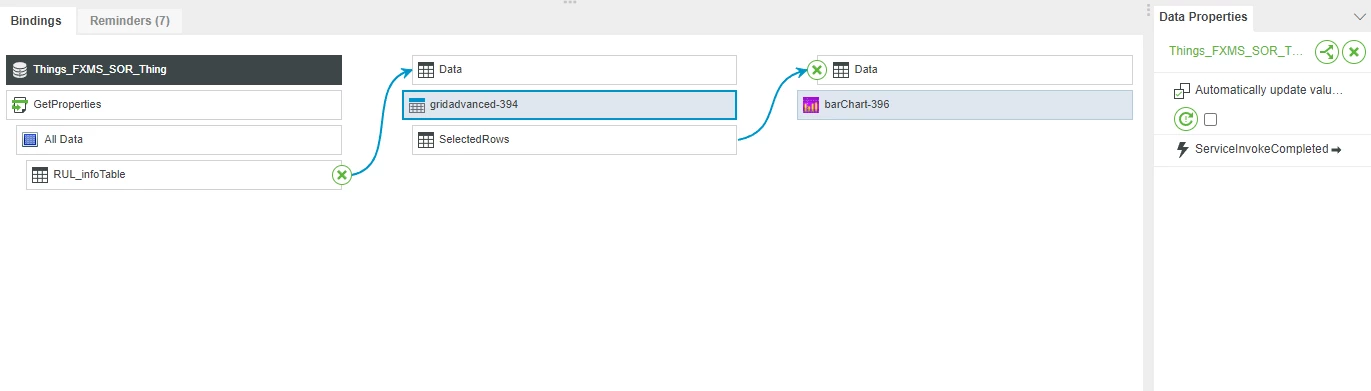

Can you tell me which part brings this flickering icon and how to remove it. I have attahced images of the bindings. The infotable name is RUL_infotable in this image.

Looking at the Binding of GetProperties.png, as PaiChung guessed, there is an inadvertent loop - After GetProperties service completes execution upon mashup loaded, ServiceInvokeCompleted event fires and executes GetProperties once again - this loop continues on and never ends with this way of binding.
The flicking effect you observed is the data loading icon keep appearing as GetProperties service keep getting executed.
If you've added an autorefresh widget, that widget comes with a RefreshNow button, bind the Refresh event of the autorefresh widget to GetProperties, that should achieve want you want to achieve - there's no need to create a separate button.
