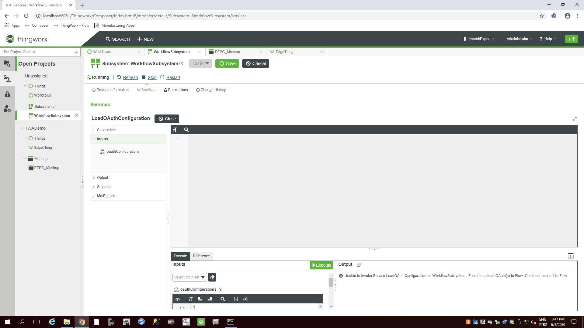

Installed Flow and TWX on same Windows box (v. 8.5.4) and when trying to execute the WorkflowSubstem, LoadOAuthConfiguration, getting the error attached,
Unable to Invoke Service LoadOAuthConfiguration on WorkflowSubsystem : Failed to upload OAuth(s) to Flow: Could not connect to Flow
I can log into the Flow webpage without any issues
Please, any ideas?
Tks,
Chris

Still not solved and just notices that besides the loadauth service not being executed, if I try to create a workflow service from a thing, i also get a 404 error,
Please, help 🙏

In order to create a workflow from a thing, you have to start ThingWorx with the same url defined for Flow.
When you run this command, does it show that everything is online?  pm2 ls
Regards.
