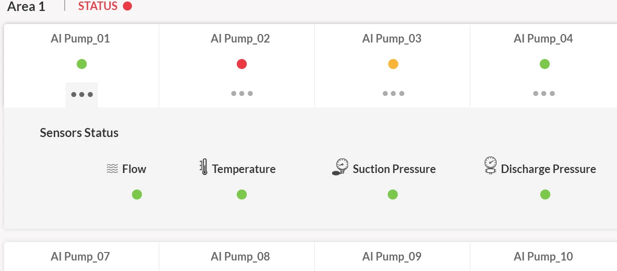

I have to develop the attached screen for a requirement. I am using Repeater for each of the individual pump status. My requirement is to design a foldable display on individual asset status once user clicks on the ellipsis in the pump block. Clicking on the ellipsis it will show the pump sensor status and again on clicking it will fold back. I thought of using foldable panel but the length of the sensor status block is too long to get contained in the panel. Any help on how this could be achieved will be great.
Note: Pump and sensor no can vary.

I think your requirement can be accomplished also with Collection widget.
Please take a look at the following post:
https://community.ptc.com/t5/Talkin-ThingWorx/New-in-8-2-Collection-and-CSS-Editor/gpm-p/535064
This is a post regarding Collection widget (similar with Repeater) and there is also an example attached, maybe you can inspire from there.
