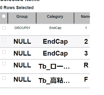

Hi Developers,
Help needs on the title.
we've upgrade TW from ver9.2 to ver 9.3 just before.
after the upgrade, the font style is automatically changed even though I use "Style Theme".
could you let me know how we can stop this change?

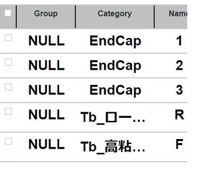

1. font pattern1
2. font pattern2
when I put(update) date with servive, then font style get normal. ( looks same as the one in "Style Theme")
3. font pattern3
when I put long text like datetime, then font size get too small.
context was Text was wrap displayed in TW ver9.2.
our TW version is the below.

Mar 3, 2023 11:09 PM UTC
Hi Jens,
Thank you for your prompt response and good input !!
I found root cause of this issue.
I use "State definition" and all text size of style definitions which are used in the State definition were changed.
I also checked if someone change it or not, but no one changed, thus the trigger of this change is possiblely the TW upgrade to ver9.3
(we had the upgrade at the end of this Jan.)
