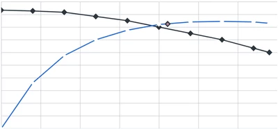

I have the use case to show one series as Line only  and other series as marker only in Line chart.
Since ThingWorx 9.2 is not having stroke property to hide the marker from series 1 and hidemarkers property will hide the markers from all series. (In ThingWorx 9.1 there was present this stroke property so it was achievable earlier)
How can we show ist series only as Line without marker and second series as marker only in ThingWorx 9.2

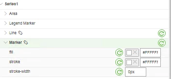

In ThingWorx 9.1 under style definitions you will get series1,series2 .. etc styles for separate series.
For the series you want to hide marker from the line just make the fill & stroke property of Marker for that series as transparent color (#FFFFFF00)
But this stroke property of Marker got removed in ThingWorx 9.2

I tried your option now but looks somewhat like below where its not getting transparent instead a  white spot.
am i doing something wrong??

Hi @RK_0705.
Which patch level of 9.2 are you on?  For 9.2.3, we can see the stroke options under Style Properties.

Hi @RK_0705.
Here's what I see under 9.2.1:
Are you expecting to see something different?
