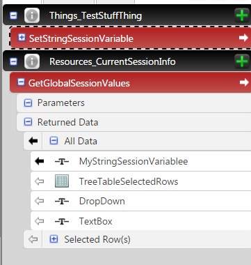

1. Create a session variable (see KCS Article CS249180 for a basic session variable example)
2. Because you are binding the value from this textbox to a session variable, back to the same textbox, you need to use a setter method and getter method. Otherwise, the textbox session variable will just be overwritten when the page is refreshed
3. Create a setter method with string input "input_str" and the following Javascript: Resources["CurrentSessionInfo"].SetGlobalSessionStringValue({name: "your_session_var", value: input_str});
4. Import this setter method and the GetGlobalSessionValues service from the CurrentSessionInfo resource in the Data tab on a mashup:
5. Add a textbox, button, and validator widget to the mashup
6. Bind the "Text" target from the textbox to the set service
7. Bind the session variable under All Data in GetGlobalSessionValues to the textbox "Text" target
8. Bind the Click event from the button to the setter service created in step 3
9. Bind the ServiceInvokeCompleted event from the setter service created in step 3 to the validator widget's "Evaluate" target
10. Set the expression of the validator widget to "location.reload()"
11. View the mashup, enter a value into the box, and hit the button; the page should reload and the box should now be selected with the same text as previously entered
Let me know your further questions on this
