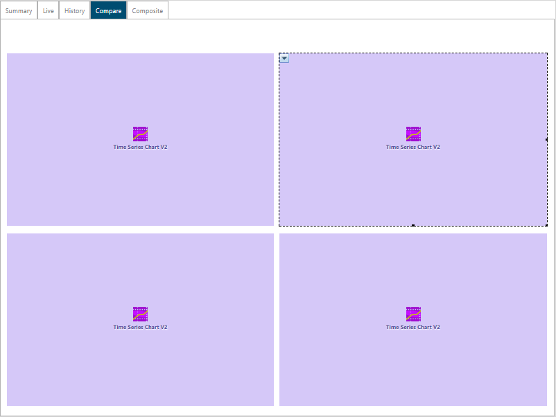

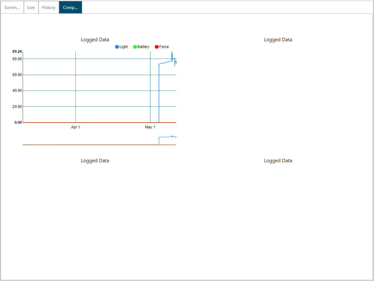

I'm working with creating a mashup that utilizes Tabs to get a specified layout, but I'm having some formatting issues. I have it set to show 5 tabs along the top of the mashup, however it will sometimes show 4 tabs or sometimes only 3. I have been able to mess with the sizing of the font and tab height to get all 5 tabs to show up in the composer, but when I got to view the mashup preview, one or two of the tabs will disappear. I have included a few screenshots to show what I am talking about.
Here it is within the composer:
And here it is on the preview:

    Tabs seem not to wrap properly in this particular scenario with larger fonts n the style definition.

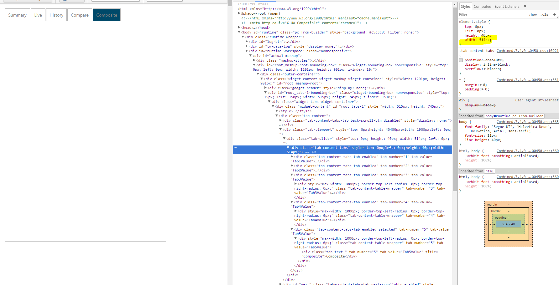

    It's a static mashup with static tabs widget. I'm currently trying to reproduce. There are a lot of problems appearing with this particular mashup, including an inconsistent default tab selection (it's set up to 1 yet shows 2):
