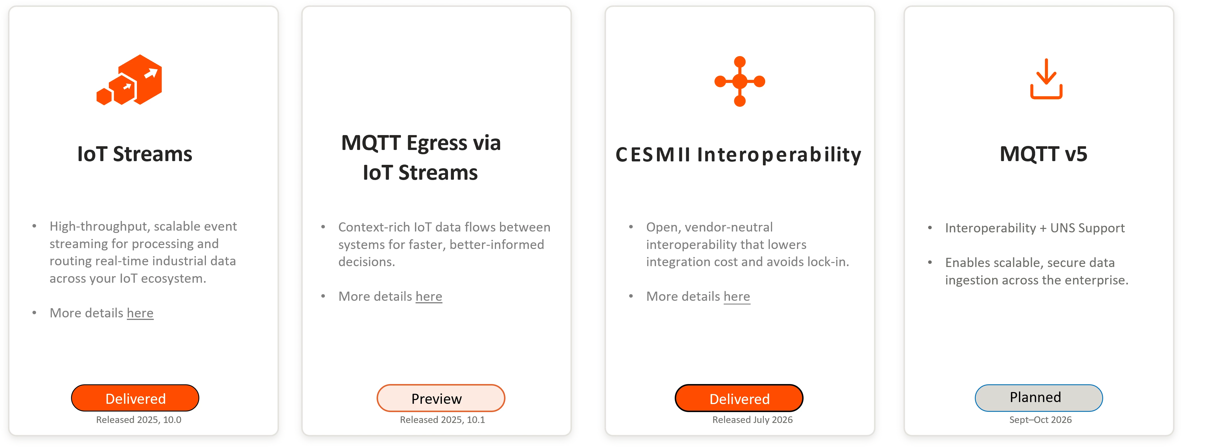

The bigger picture: interoperability, not another connector
Industrial architectures rarely consist of a single system or protocol.
There are machines and controllers, SCADA systems, historians, MES platforms, cloud services, analytics applications, AI systems, and increasingly, applications that need to consume information in real time.
That makes interoperability a strategic requirement.
ThingWorx has been progressively expanding its interoperability capabilities. The enablement roadmap highlights IoT Streams, MQTT egress through IoT Streams, CESMII interoperability, and now MQTT v5 as steps toward a more open industrial data ecosystem.
ThingWorx is committed to Interoperability
The common thread is simple:
Industrial data shouldn't have to stay trapped inside the system that generated it.
It should be possible to ingest it, contextualize it, process it, and make it available to the applications and systems that need it—including analytics and AI applications.

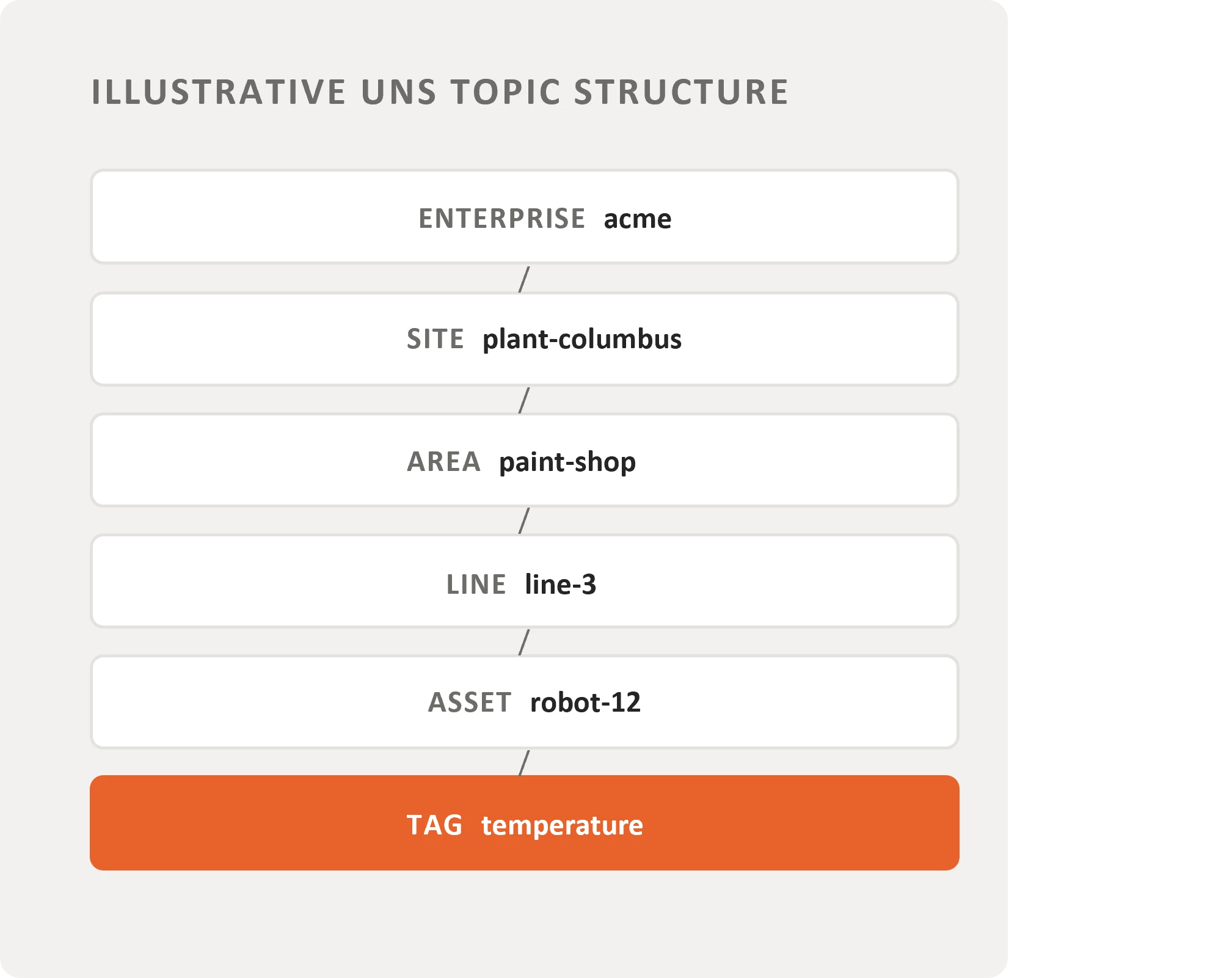

So, what does Unified Namespace actually mean?
The term Unified Namespace can sound more complicated than it really is.
At its core, the idea is straightforward:
Systems communicate based on what the data means—not simply where the data came from.
Instead of thinking:
“I need to connect to the MES system to get this value.”
you can think:
“I need the production data for this line.”
The business context becomes part of the way the data is organized.
For example, a UNS topic might follow a structure such as:
enterprise/acme/site/plant-columbus/area/paint-shop/line/line-3/asset/robot-12/tag/temperature
The exact topic hierarchy can vary by implementation, but the important idea is that the topic itself carries meaning.
The data isn't just:
72.5
It is:
temperature → robot-12 → line-3 → paint-shop → plant-columbus → acme
That context makes the data significantly more useful to the applications consuming it. The ThingWorx 10.2 enablement material describes UNS specifically as topic-centric business semantics, where applications publish and consume data based on business meaning.

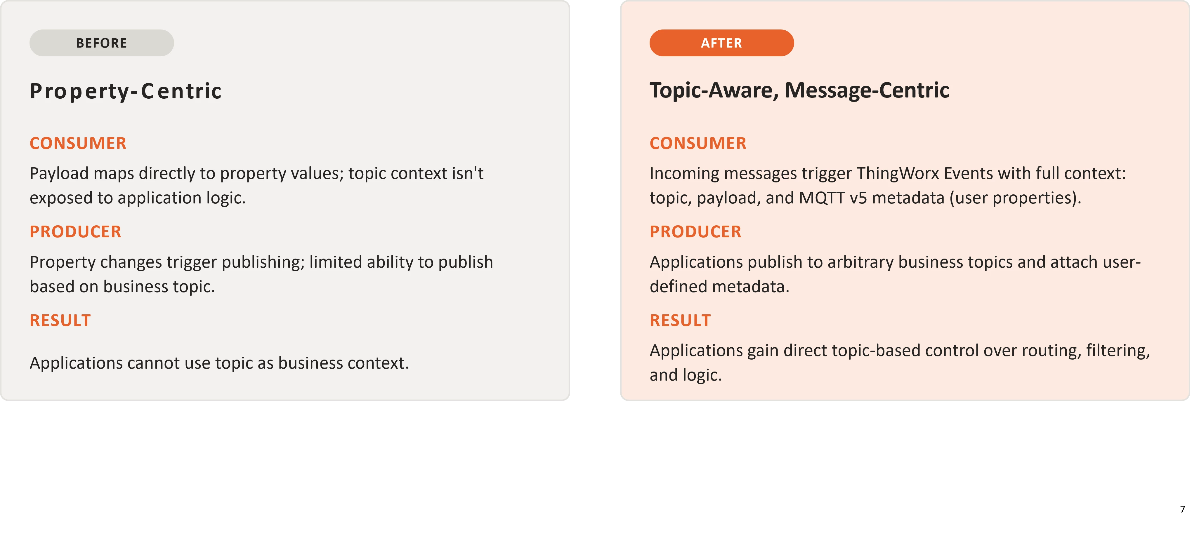

The shift: from values to context
This is where the MQTT v5 work becomes particularly important.
Historically, MQTT integration in ThingWorx has been largely property-centric.
A message arrives, its payload gets mapped to a property, and the application works primarily with that property value.
That works well when all an application needs is the value.
But what if the topic itself contains important business context?
In a UNS architecture, the topic can tell an application what the message represents.
With the MQTT v5 capabilities, ThingWorx moves toward making that context accessible to application logic.
On the consumer side, incoming MQTT messages can trigger ThingWorx events with:
  • the topic
  • the payload
  • MQTT v5 metadata, including user properties
On the producer side, applications can publish to arbitrary business topics and attach their own metadata.
This creates a fundamental shift:
Before
MQTT delivered a value.
Now
MQTT can deliver information together with its context.
And that distinction matters.
Because once an application understands the topic, it can use that information for routing, filtering, and application logic, rather than treating the topic as something external to the application.
