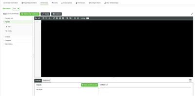

Hi all,
Is there any way to get a full screen dark mode in composer rather than just the code box? Or a work around to get it to be full dark mode?

Hi @JK_10744682
I played around with it a little but it appears that only the Service editor is affected.
I recommend posting a request for it on the Ideas board.  That will allow others to vote for it, which is helpful for gauging whether there is widespread interest.

I don't think there is a direct way.
You could change the css (twx-default.css, all-twx-default.css) in the tomcat directory, or use a browser addon like NightEye. Not sure how good that works.
