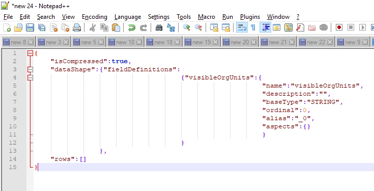

I tried that before I posted here but it didn't work.
This is what I got from Chrome after running the service.
