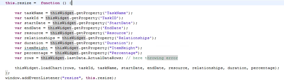

         I am using Gantt Chart extension from PTC Marketplace. When I configured and run the mashup it's giving error as "TypeError: Cannot read property 'ActualDataRows' of undefined at resize". (Please refer the below code and the attached image file)
        Could you please help me for the same as I am working on the custom widget and following the same code as Gantt Chart extension from PTC Marketplace.

		this.resize = function () {
			var taskName = thisWidget.getProperty('TaskName');
			var taskId = thisWidget.getProperty('TaskID');
			var startDate = thisWidget.getProperty('StartDate');
			var endDate = thisWidget.getProperty('EndDate');
			var resource = thisWidget.getProperty('Resource');
			var relationships = thisWidget.getProperty('Relationships');
			var duration = thisWidget.getProperty('Duration');
		 var itemHeight = thisWidget.getProperty("ItemHeight");
			var percentage = thisWidget.getProperty("Percentage");
var rows = thisWidget.lastData.ActualDataRows; //here throwing error thisWidget.loadChart(rows, taskId, taskName, startDate, endDate, resource, relationships, duration, percentage); }; window.addEventListener("resize", this.resize); }; } ());
rasAnswer
I have figured out this issue, this error caused because data service not having a triggering event.

ras1-VisitorAuthorAnswer
