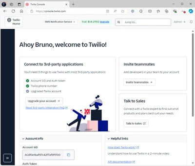

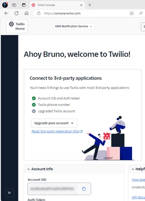

Step 1:  Set Up Twilio Account
Make sure you have a Twilio account and have your Account SID, Auth Token, and a Twilio phone number.

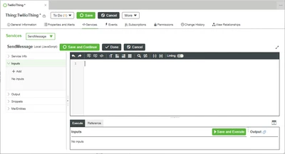

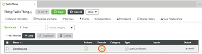

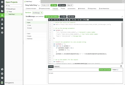

Step 2:  Create a ThingWorx Service
In ThingWorx, create a new service in your Thing or ThingTemplate.
As an example, below I created a “Thing” called “TwilioThing” with a service called “SendMessage”:
Step 3:  Write the Service Code
Use the following code as a template for your service. This code will make an HTTP POST request to Twilio's API to send a message.

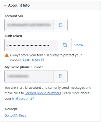

Step 4:  Replace Placeholders
Make sure to replace the placeholders (YOUR_ACCOUNT_SID, YOUR_AUTH_TOKEN, RECIPIENT_PHONE_NUMBER, YOUR_TWILIO_PHONE_NUMBER, YOUR_MESSAGE) with your actual Twilio credentials and message details.

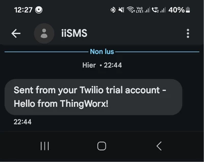

Step 5: Test the Service
Save and test your service to ensure it sends the message correctly.
