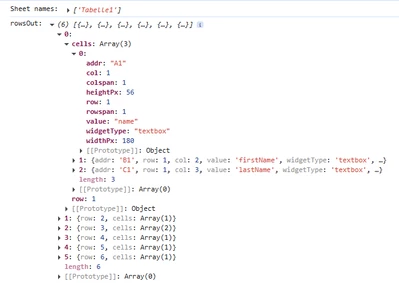

Generate Mashup XML with Parsed Excel as Extension
I’ve parsed an Excel file on the client using SheetJS and now have a clean JSON spec of the UI (fields, checkboxes, etc.). Next step: generate a Mashup XML from that spec and create the Mashup in ThingWorx automatically.
Results after parsing excel are as below. It gives complete results like how many widgets in one row and then width and height of that widget with all requried details which would be very helpful to now generate a mashupXML
What would you recommend? that how can i now write a file and upload it in thingworx. should i upload this as extension the parse excel code  and then get that results in mashup somehow and then bind it to another extension may be in nodejs to do this job for me to write xml and upload in thingworx.. I have confusions about it like how can nodejs create a file and then upload it in thingworx as extension. (i know how NODEJS can create file but in thingworx context i have confusions)
