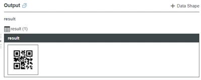

Hi all,
I have a STRING field, using which I have to generate a QR Code that has to be printed later.
Is there any way to generate a QR Code in Thingworx 9.2.3
Thanks in advance,
Sujith
CharlesJiAnswer
Support
May 24, 2022 6:55 AM UTC
Hi @SB_9732186, you can try to use the QR Code generate API from other websites, e.g., Google QR Code (https://developers.google.com/chart/infographics/docs/qr_codes).
In ThingWorx, you can simply create a service with the following to get a QR Code with 200x200 size saying "Hello_World":
let params = {
	proxyScheme: undefined /* STRING {"defaultValue":"http"} */,
	headers: undefined /* JSON */,
	ignoreSSLErrors: undefined /* BOOLEAN */,
	useNTLM: undefined /* BOOLEAN {"defaultValue":false} */,
	workstation: undefined /* STRING {"defaultValue":""} */,
	useProxy: undefined /* BOOLEAN {"defaultValue":false} */,
	proxyHost: undefined /* STRING {"defaultValue":""} */,
	url: "https://chart.googleapis.com/chart?cht=qr&chl=Hello_world&choe=UTF-8&chs=200x200" /* STRING */,
	timeout: undefined /* NUMBER {"defaultValue":60} */,
	proxyPort: undefined /* INTEGER {"defaultValue":8080} */,
	password: undefined /* STRING */,
	domain: undefined /* STRING {"defaultValue":""} */,
	username: undefined /* STRING */
// result: IMAGE
let result = Resources["ContentLoaderFunctions"].LoadImage(params);
