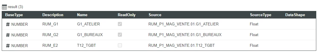

Thank you @slangley for your reactivity,
I found a solution using just some for loops, to browse all tags from an industrial connection, using just 2 services ; browseGroups and BrowseItems,
please find this attached my solution
// this service is for browsing all tags of an industrial connection
//level 1 : Groups
//level 2 : SubGroups
//Level 3 : items or Tags
var IndustrialConnectionThingName ="YourIndustrialConnectionThingName";
//get Groups
var Groups = Things[IndustrialConnectionThingName].BrowseGroups({
    filter: undefined /* STRING */,
    path: undefined /* STRING */
var resGroups = [];
for (var x=0; x <  Groups.rows.length; x++){
    var row = Groups.rows[x];
    var hasAnySubGroups = row.HasAnySubGroups;
    var IsSystemGroup = row.IsSystemGroup;
    var HasNonSystemSubGroups = row.HasNonSystemSubGroups;
    if(!IsSystemGroup &&HasNonSystemSubGroups && hasAnySubGroups){
        var groupFullPath = row.FullPath ;
        resGroups.push(groupFullPath);
//Get SubGroups
var resSubGroups = [];
for (var i=0; i < resGroups.length; i++) {
    var resGroupsRow = resGroups[i];
    var SubGroups = Things[IndustrialConnectionThingName].BrowseGroups({
    path: resGroupsRow /* STRING */
    for (var j=0; j < SubGroups.rows.length; j++) {
        var SubGroupsRow = SubGroups.rows[j];
        var hasAnySubGroups = SubGroupsRow.HasAnySubGroups;
        var IsSystemGroup = SubGroupsRow.IsSystemGroup;
        var HasNonSystemSubGroups = SubGroupsRow.HasNonSystemSubGroups;
        if(!IsSystemGroup ){
            var SubGroupFullPath = SubGroupsRow.FullPath ;
            resSubGroups.push(SubGroupFullPath);
// Get Items === Tags
//var resItems  = [];
// CreateInfoTableFromDataShape(infoTableName:STRING("InfoTable"), dataShapeName:STRING):INFOTABLE(IndustrialItems)
var resItems = Resources["InfoTableFunctions"].CreateInfoTableFromDataShape({
    infoTableName : "InfoTable",
    dataShapeName : "IndustrialItems"
// iterate over resSubGroups to get items
for (var p=0; p < resSubGroups.length; p++) {
    var resSubGroupsRow = resSubGroups[p];
        // result: INFOTABLE dataShape: "IndustrialItems"
    var items = Things[IndustrialConnectionThingName].BrowseItems({
        path: resSubGroupsRow /* STRING */
    //iterate over items to find tags and push them in resItems
    for (var k=0; k < items.rows.length;k++) {
        var itemsRow = items.rows[k];
        //var TagName = itemsRow.Source ;
        //resItems.push(TagName);
        resItems.AddRow(itemsRow);
//infotable : datashape : industrialitems
result = resItems;
