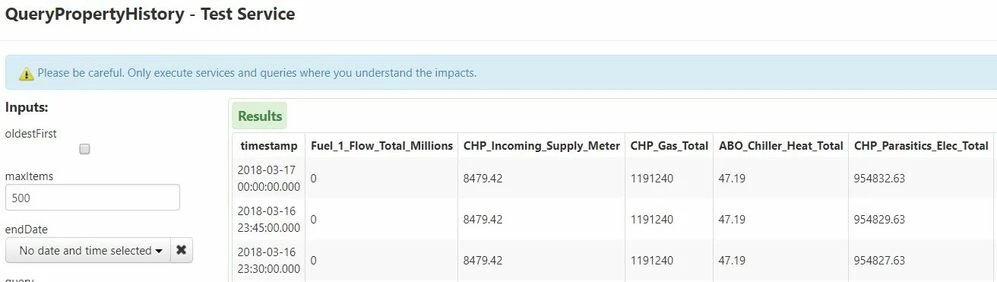

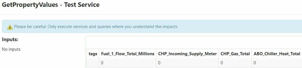

Does anyone know of the best practice to get the most recent stream entry without using: GetProperties or  GetPropertyValues?
I am inputting CSV data into a stream. When I call either GetProperties or GetPropertyValues this returns 0 even though the QueryPropertyHistory has values.
Any guidance would be appreciated!

It's the queryProertyHistory only which displays value being logged in a value stream. This can be used in a mashup to retrieve the values in a chart .The point is you can use this service in as dynaic ThingTemplate and that can take your thing name as entity name and will take out logged stream entries for your thing on the mashup.So basically you don't need a getPropertyValues/getProperty for this use case .
I think i addressed your question in right direction .You can also see this kind of use in below video tutorial .
https://www.youtube.com/watch?v=Z4-ALgFKNpE&feature=youtu.be
