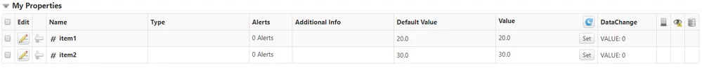

I am trying to GET multiple property values of a single THING. I saw posts using POSTMAN, but I'm trying to use Python REST API. I have created 2 items and given them default values. In the below code, I am able to print a single value of the property "item1"  which is 20.0. How do I fetch all properties using a single REST API call?items.PNG

Aug 17, 2018 10:07 AM UTC
You called the wrong API.
There is a service called GetPropertyValues in most Things, if you use this API, you can get an infotable of the results, and you can print the values you want. (infotable in Python is probably a Matrix)

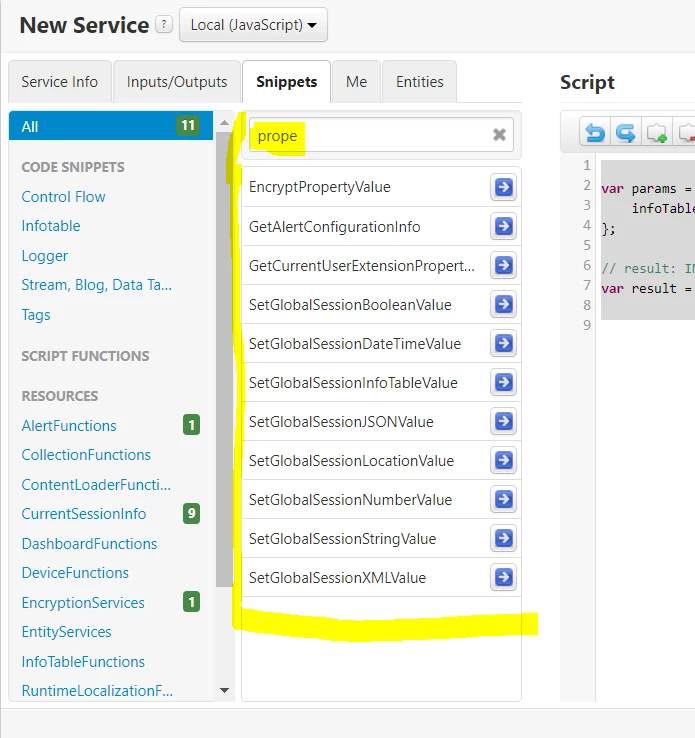

Aug 17, 2018 11:11 AM UTC
I do not find the service listed in the section. Is it a custom function that we should write?
