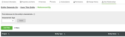

I am trying to get the thingname of the a service that called another service. Suppose we have a service called ServiceA that can call a ServiceB in Thing1, and a ServiceC is also able to call this ServiceB in Thing2. Suppose service3 is in a Thing3. I want to know if there is a way to trace what thing called ServiceB. Is this possible?
I'm in Thwx 9.5
Support
May 9, 2024 1:49 AM UTC
Hi @MF_10165907, once you enabled the Enable Referenced By flag under the configuration of the RelationshipSubsystem, you may find the reference list of any specific Thing under ViewRelationships > Referenced By.
In your case, you can view the reference list from the Thing where ServiceB is located.
