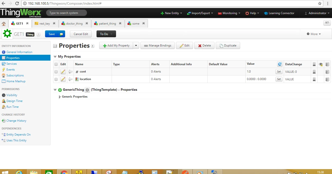

i attached a image of my Thing created in Thingworx.
please suggest me. how to use that data coming from Thingworx to Trigger my raspberrypi.
