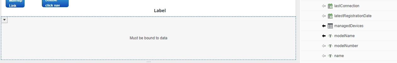

What I am doing is populating several labels and a grid within my mashup using a service (MyAsset is a parameter that allows me to dynamically load different assets):
var result = Things[MyAsset].GetPropertyValues();
So I have something like (image2)

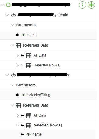

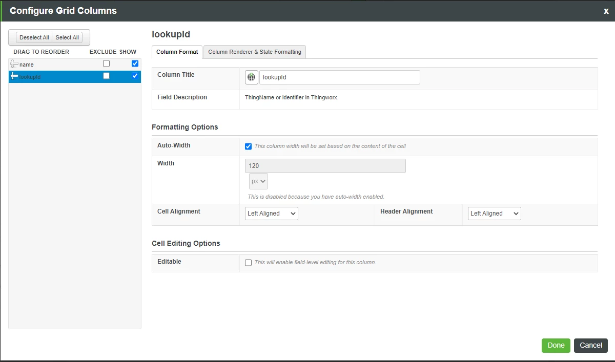

I have two columns in the grid (image3)
name
looupId
I want to extract the lookupId value of the selected row

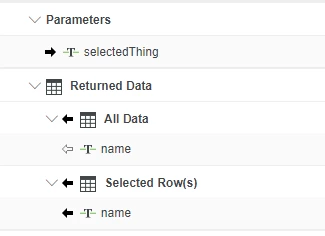

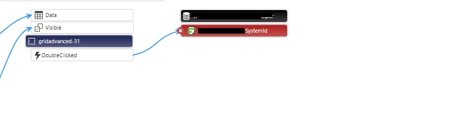

One idea I tried to implement was to call a service when double clicking the row (image4)
and after the service call ends I execute the navigation passing the parameter I need from the result of service call. But I had no success

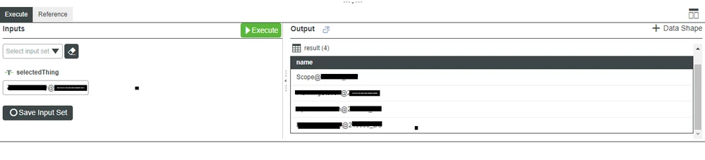

I defined a one field datashape (image 1 )
I am populating the grid using a direct service (not via the properties of the  script I shared)

This returns an infotable with the correct datashape:
So far so good:
I am binding Returned Data -> All data to my grid and this works fine
Problem comes when binding the Selected Rows-> name
I first tried to bind this to a label to see if I can extract the selected row value, but label does not change its value.
Then I thought the problem should occur because there is no event that updates the label value so I created a service that is called when double clicking
the row like:
var result = name;
I am passing the parameter "name" from selected row service:
Summary
When I click on a row from grid I call a service (the parameter comes from my populate grid service selected rows name field from datashape)
I am binding the result of this servide to label value to extract the grid column value, but I get undefined value
