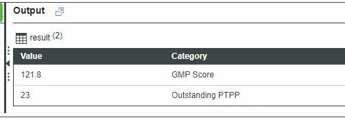

May I know how to get Value "23" based on Category "Outstanding PTPP" and pass value to another Datatable using for loop?
rosharmaAnswer
December 2, 2019
below snippet will help you out. first get the datatableentry by key
iterate that to get value
now create infotable structure according to other datatable
set values to infotable entry and use adddatatableentry
