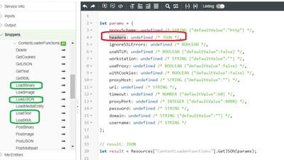

TW RestAPI is not strong as Postman, the best solution is let 3rd party service send back a normal JSON format response.
Except that, hHave you tried tunning the header option of GetJSON parameter? (red line). For example, set "*/*" for Accept option of header.
Besides, there are other services you can verify(green line), such as LoadBinary, LoadJSON.

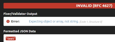

I would suspect that just "somevalue" is not a valid json response. E.g. when trying to parse just a string in JavaScript
Actually wikipedia states that RFC 4627 is the latest json spec since 2006. And also e.g. https://jsonformatter.curiousconcept.com/# when choosing this RFC says it is not valid
I did not research what RFC is used by TWXs json interpreter but I assume it will be the same like I have in my browser (1st screeshot) which says its not valid.
Because of that I would try to just user GetText
(return type String)
result = Resources["ContenLoa..."].GetText(..
If this would have your expected response, you could interprete it like you want. Hope this works as it may complain about the actual Content-Type send by the server.. Worth a try.
I am not clear what "GetText does not work as the response is automatically formatted as JSON" means exactly - if it throws an error or what does not work here.
