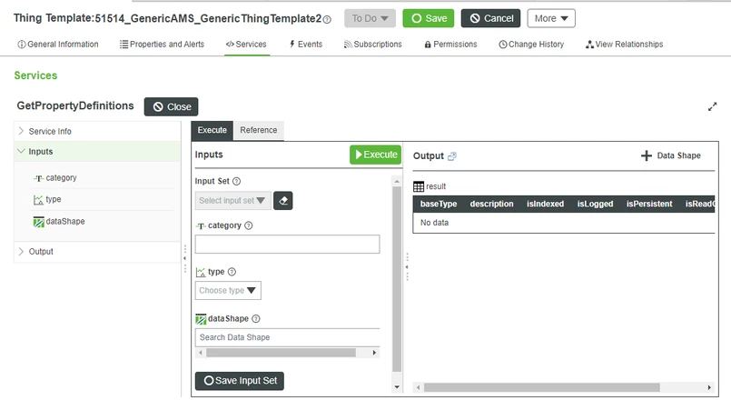

GetPropertyDefinations in ThingTemplate
I created a couple of properties in a ThingTemplate and I wanted to retrieve them using the service "GetPropertyDefinations" but there is no data in a result . so how  can I retrieve the Property names from ThingTemplate?

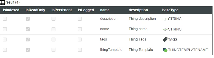

Can you please try
// result: INFOTABLE dataShape: "PropertyDefinition"
let result = ThingTemplates["GenericThing"].GetInstancePropertyDefinitions({
type: undefined /* STRING */
ashaban12-AmethystAnswer
Sep 6, 2023 2:52 PM UTC
Can you please try
6-Contributor
Sep 7, 2023 4:50 AM UTC
I appreciate the solution provided, but my specific need entails filtering the properties after acquisition, primarily based on their category or multiple base types.
