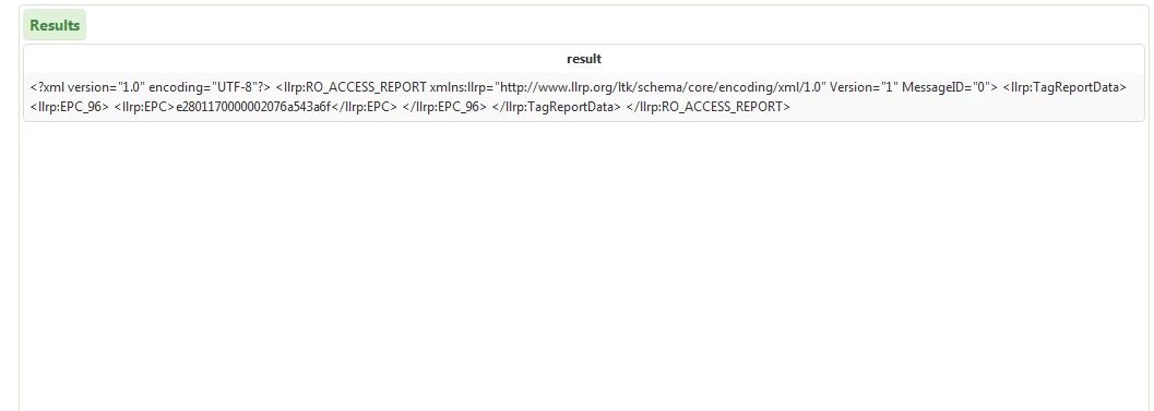

So, I was able to use GetText to pull in the entire XML.  I am not concerned with keeping the XML format as I only need to extract the tagid itself.  This should work! I want to take that value and assign it to a thing property (which I can do).
However, I am interested in knowing why I couldn't extract the value by simply using the GetXML snippet.  Looking at the XML as text, it should have worked (see attached).
Mar 10, 2018 9:01 AM UTC
Server Side TW Javascript has ECMAScript (E4X) embedded, you can just work with XML documents out of the box.
