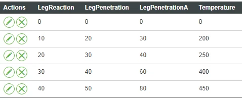

Hi all, I am trying to get the number of field definitions from my infotable as shown.
In this case, I want the number of field definitions to return 4. I've tried using getFieldCount() but it doesn't seem to work, any help will be greatly appreciated!

There you are:
myProperty.dataShape.fields.size()

Hi @Constantine, thanks for reply. I am actually using an IDE to create a custom widget so your solution might not be applicable. Therefore, I will be using mine as shown in the code below.
this.updateProperty = function (updatePropertyInfo) {
 var widgetProperties = this.properties;
 var dataRows = updatePropertyInfo.ActualDataRows;
 var nRows = dataRows.length;
 var rowData = new Array();
 for (var i = 0; i < nRows; i++) {
 rowData.push(dataRows[i]);
console.log(Object.keys(rowData[0]).length); //returns 4
