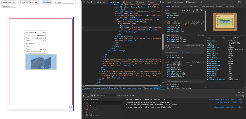

Feb 2, 2024 9:43 AM UTC
Hey,
I have exactly the same issue like @oskarberntorp and I tried the CSS of @yalmatar . Unfortunately the provided CSS for the "popup-root" does not work. I am not able to set the height and width of the popup-root part to 100%, which seems to be the last missing part for the solution
My ThingWorx Version: 9.4.3-b523.
These are my CSS classes.
.ValueDisplay .widget-ptcsvaluedisplay::part(value-display-area){
 height: 100% !important;
 width: 100% !important;
.ValueDisplay .widget-ptcsvaluedisplay::part(overflow-control){
 border: solid blue 2px !important;
.ValueDisplay .widget-ptcsvaluedisplay::part(value-container){
.ValueDisplay .widget-ptcsvaluedisplay::part(disclosure-button-overlay){
 box-sizing: content-box !important;
.ValueDisplay .widget-ptcsvaluedisplay::part(item-value-container){
.ValueDisplay .widget-ptcsvaluedisplay::part(item-value){
 border: solid red 2px !important;
.ValueDisplay .ptcs-value-container .ptcs-modal-image-popup::part(popup-root){
 border: solid orange 2px !important;

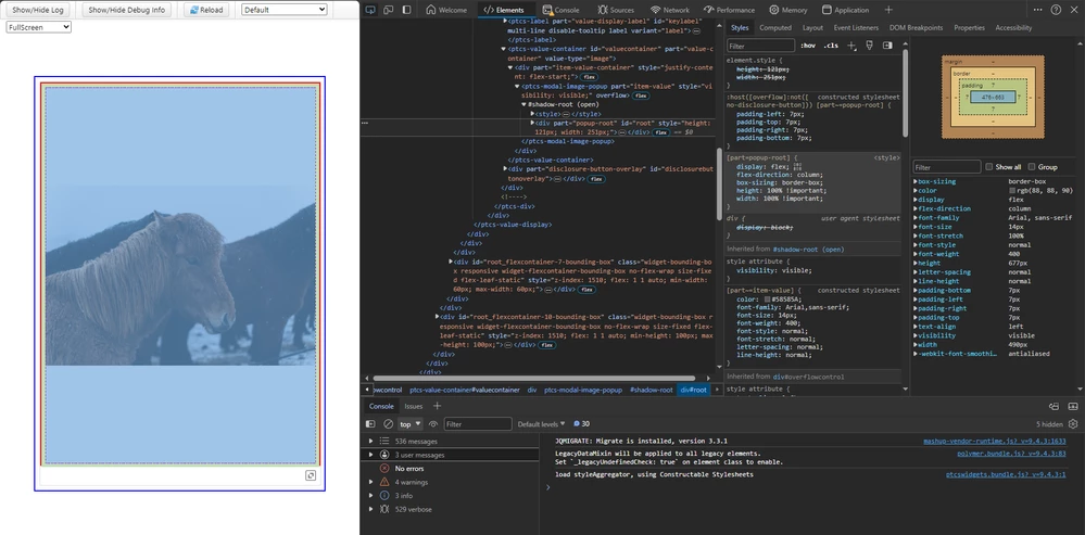

You can see the popup-root part and the class with the height of 121px and a width of 251px.
When I manually change the height and width of the popup-root class I get the desired solution.
Maybe someone can help me out here ( T o T )
Best regards
Markus
