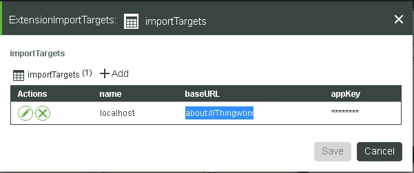

  • When pressing the "Import Extension" button nothing happens. No message is displayed in the panel in the lower part of the screen.
  • ApplicationLog file shows the following messages:
    • 2020-07-24 17:40:38.453+0000 [L: ERROR] [O: c.t.r.ExtensionsExport] [I: ] [U: Administrator] [S: ] [T: http-nio-8080-exec-8] Import target baseURL missing protocol [about:///Thingworx/ExtensionPackageUploader?purpose=import&validate=false]
    • 2020-07-24 17:40:38.465+0000 [L: ERROR] [O: c.t.r.ExtensionsExport] [I: ] [U: Administrator] [S: ] [T: http-nio-8080-exec-8] Error in ContentLoader.postMultiPart: check your inputs! URI does not specify a valid host name: about:///Thingworx/ExtensionPackageUploader?purpose=import&validate=false
  • The importTargets infotable property of the ExtensionImportTargets Thing has the followinfg valueScreenshot from 2020-07-24 15-52-54.png
    • That is, the row[0] baseURL field value is "about:///ThingWorx"

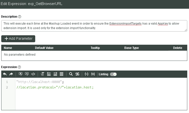

Solution
The responsible of setting that wrong baseURL value is the exp_GetBrowserURL expression.
So, I hardcoded it to the string "http://localhost:8080" and it worked fine.
I believe there might be a general better solution. So feel free to comment.
