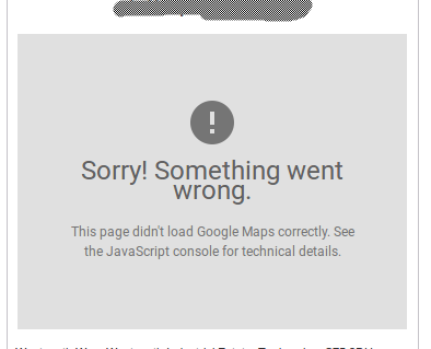

All the google maps in my mash ups have stopped displaying (the widget area is blank). They all used to work fine. The only thing I can think of that might have affected it is that we changed the to a https connection from http. I have looked for solutions on the web, but can't find anything. Has anyone come across this issue before?

Hello, did you try this: Article Viewer | PTC
October 16, 2017
which browser are you using?
Can you try logging through an other browser and see.

thanks for getting back to me. I'm using Chromium browser (a derivative of chrome). I have tried it on Firefox but got a similar result.

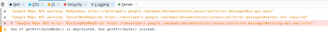

I'm fairly new to web development so am not familiar with the JavaScript debugger on the browsers, but looking in the console it appears that the issue is to do with API keys?

Thank you. I can see what the problem is now.
