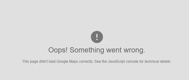

I tested the stock Google Maps widget v3.0,3 as downloaded from marketplace to see what errors I get with no app key and with an incorrect app key.
No App key at all shows this when I view the mashup
In incorrect app key shows this in the mashup
Neither case showed the error you are seeing in the JS console, but I was testing a simple mashup that only had the map on it. i would download a new copy of the widget from the marketplace and set your key in the ThingWorx UI instead of doing it inside the widget files, then test with a simple mashup.
To your question about why it would just stop working; it is possible Google changed how they respond to your mashup's calls to their map image server. They have been slowly tightening what they allow and I have seen many commercial websites showing broken maps lately.
