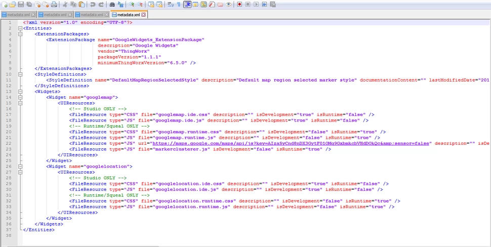

As per this Article, the Google maps API key has been inserted into Google Widgets Extension Package downloaded from the marketplace.xml2.PNG

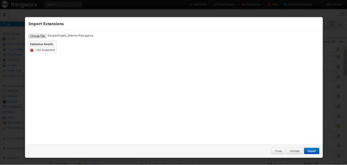

 Then,i re-zipped it and tried to import into the Hosted Server, but it says Validation: Not Acceptable and fails to import.IMPORT FAIL.PNGNow, How shall i proceed to use the google maps widget in my Hosted Server??
Kindly respond.

Where did you download your google maps extension from? That version in the screenshot looks pretty old. What is your ThingWorx  platform version? I would suggest downloading an appropriate newer version from the marketplace.
You may also see a more detailed error in the ApplicationLog (in your composer monitoring tab).

Hii..Thank u so much..The issue has been resolved..The problem was with the metadata xml..I checked out Application log and resolved it..
