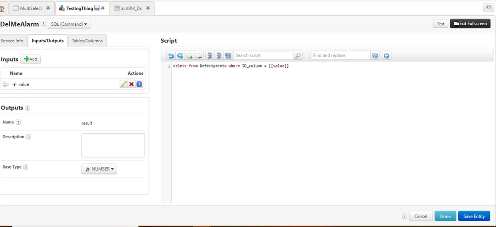

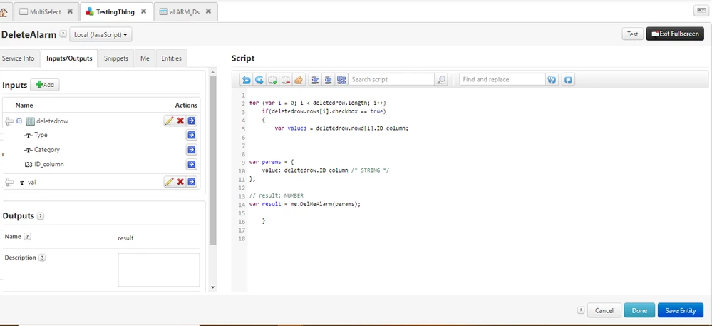

I am using grid advanced v4.1 and I wanted to multi select and delete the grid rows. I have written a service to perform this but it isn't working. Please provide me idea to achieve this. I have given the default infotable datashape to the service which is the grid's datashape.Delete1.pngDelete2.png Thanks.

I think you are forgetting to carry the row index in your params block for the Value you assign to match to delete on.

Also Should I be creating a data table for delete snippet? Because i have been calling the delete service so I think I am not getting the desired output.
