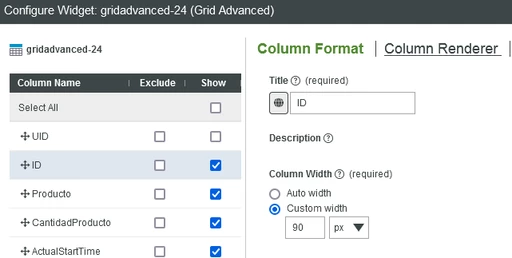

We are using grid advancet widget, and the user can modify the column width during runtime .
Is it possible to freeze column width?
Thanks in advance.

We set column width using pixels, but during Runtime the user can modify it...
We are using 9.1.3.

I am not aware of such capacity on Advanced Grid (even using configuration JSON I don't think this is manageable)
In 9.3, with the new grid, you will have this feature.
