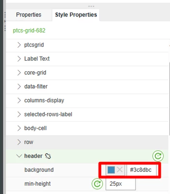

I am using GRID from Thingworx 9.3.6, I have given the background color of the Grid Header in the Style Properties, as you can see in the below.
But in the Runtime, it still shows, white in the background of the Header.

Hi @pshashipreetham
It does work properly in 9.3.6 & 9.3.7
Could you please check if any custom CSS or custom widgets affecting the grid

I tried it in a separate mashup, too, but the same result. Do you have Custom CSS we can apply for the header background for the GRID?

@pshashipreetham ,
Is there a Master Mashup assigned ?
Are you trying to set the Column background color or the Grid Title background color. They are set in different parts of the Theme.
Have you modified any other theme items which apply to the grid?
