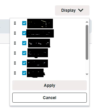

Please have a look at the attached Display feature to select columns of grid widget.I am using custom css because the font-family I need doesn't exist by default.
I would to change font-family for Display button and the blackened column options too for grid widget.I tried but no luck.Kindly provide me custom css for the same.
May 29, 2025 2:06 PM UTC
@supports (ptcs-style-unit: "PTCS-TEXTFIELD") {
    [part~=text-value] {
        font-family:
        font-size:
@supports (ptcs-style-unit: "PTCS-CHECKBOX") {
    [part~=label] {
        font-family:
        font-size:
@supports (ptcs-style-unit: "PTCS-COLUMNS-DISPLAY") {
    [part~=apply] {
        font-family:
        font-size:
    [part~=cancel] {
        font-family:
        font-size:
Able to find the solution
