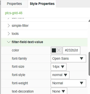

Please check the attached image.
Need help to update css of filter box in Grid widget. Providing the sample that I tried which didn't work.

Hi @krishnakomal123,
It is recommended to use Style Properties tab to configure the font-family for text value in Grid filter.
However, if you really need to apply a font-family that is not available in the list for some reason, you need to target the text-value part of the ptcs-textfield in custom CSS.
Please try the below CSS; I'm using cursive so that whether the font-family is applied or not should be easily noticed.
@supports (ptcs-style-unit: "PTCS-TEXTFIELD") {
 [part~=text-value] {
 font-family: cursive !important;
