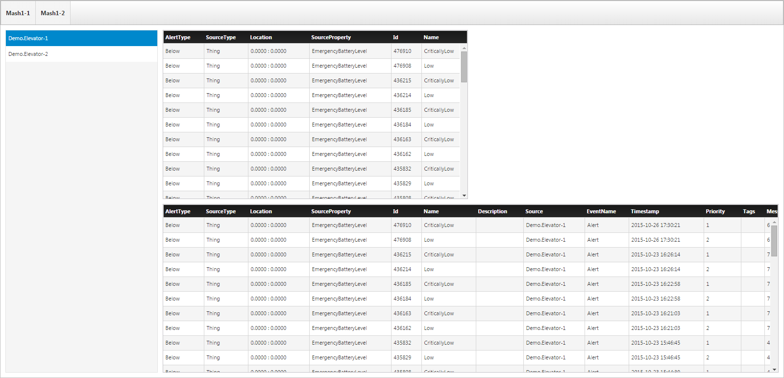

Grid widget not displaying horizontal scroll bar
I have a grid widget where the number and size of the columns is large than the screen width. I was expecting to get a horizontal scroll bar so I could see columns further to the right, but I can't seem to get that to show.
I've tried this in both Chrome and Firefox with the same result. I can zoom out with the browser so that the font is small enough and can then see all the other columns (so I know they are there). I don't see any Grid Widget properties related to this, nor do I see any Configuration options for the grid that related to this (I'm using 'auto width'). The grid is contained in a responsive Layout.
Anyone have a similar experience and figure out how to get the horizontal scroll bar to appear on grids? I'm told it does work for others!

Are you using the Converge Business Process Extension?  There's a bug in it which would cause this; it's supposed to be fixed in the next release, which I believe is scheduled for 12/15 next week.
http://converge-overflow.ptcnet.ptc.com/index.php/305/putting-grid-on-mashup-and-no-horizontal-scrollbar-appears?show=30…

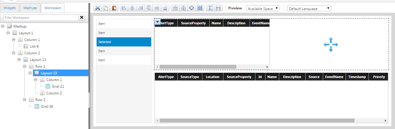

How is the actual workspace of your mashup ?
pschmaltz5-Regular MemberAuthor
December 11, 2015
Quite simple workspace of just a few responsive layouts into which I put a grid widget in a column or row. Here's a simple example using just defaults and binding to QueryAlertHistory to get some data:
The results on the top grid vs. the bottom grid show how there are more columns to the right to be seen, but yet I'm not getting horizontal scroll bars in either case to see the remaining columns to the right:
Others have mentioned having scroll bars show up, so it must be a capability. It's got to just be some silly setting I'm overlooking somewhere. Any insights on what that might be appreciated!
