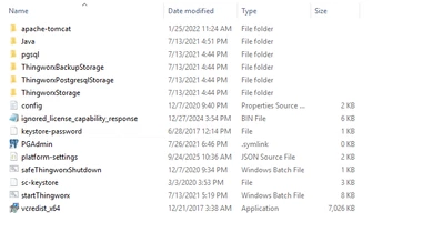

Hi Rocko
Where can i get DB creation scripts in side Thingworx folder, below is screenshot of items inside Thingworx folder.
Rocko
Sep 24, 2025 1:23 PM UTC
You need the Zip file you downloaded from PTC, or re-download it. Inside you will find the install folder.
