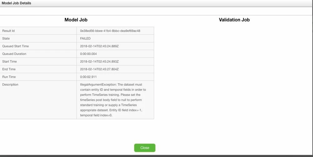

Setup - Thingworx 8.1 (Windows) and Thingworx Analytics 8.1 (Standalone linux)
I am trying to import dataset into analytics builder file attached (json and csv) bascially its exchange rates
and the first column is time stamps every 15 mins .
Ive managed to get the data into analytics builder when i use this meta data configuration note bold for the time stamp
"fieldName": "Time",

but when i try building models from this dataset it runs for a while maybe 15 seconds and then i get this errorscreenshot12.jpg
Now i know im probably not using the correct format and "opType" for the time stamp in the configuration metadata files,but i cant find appropriate documentation to assist with this. Tried the Transition guide for 8.1 but nothing really about specific time-series data types . If anybody know where i can find documentation on json metadata configuration just point me in the direction please.

Hi
For a time series dataset you need to have 2 specific additional fields compare to non time series one.
One field is with the opType TEMPORAL as you did already.
The other field is with opType ENTITY_ID. The entity_id field is used to identify the source of the data. one csv dataset can indeed contains temporal data from different sources, the entity_id allows to identify this source.
In your example you probably should add a column with the name of the stock you are following and set this as the entity_id. So if you follow different stock you will have different entity_id in your csv each with multiple rows at different temporal time.
If you follow only one stock, you still need to have this entity_id column. It will simply be set to the same value for all records.
Note also that the Temporal field is expected to be a number, so you may have to change the date format to use an increment from a starting point instead of an actual date.
Hope this help
Kind regards
Christophe

Feb 15, 2018 10:05 AM UTC
Hi Paul
The description of the different opType (including TEMPORAL and ENTITY_ID) is covered in the transition guide p. 29.
