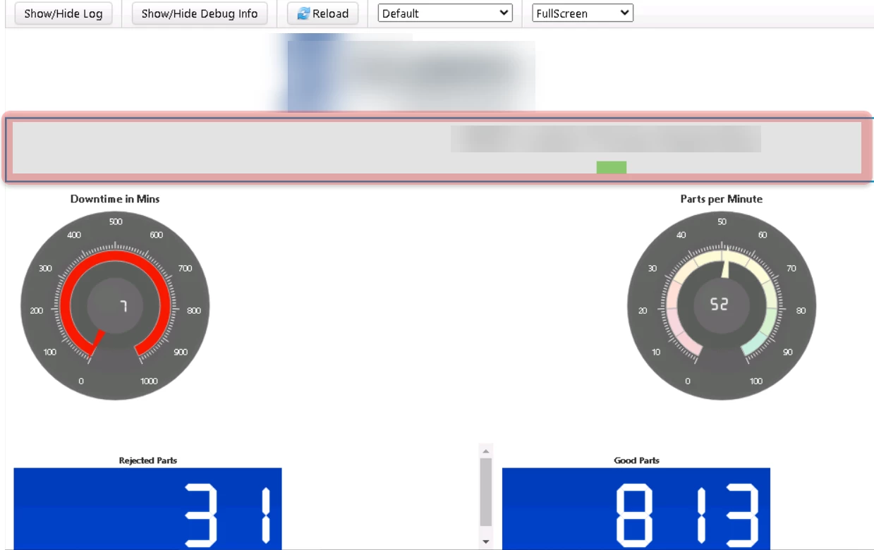

Hi all,
I am wondering if there is a way to enlarge the area of a Value Display widget that changes color based on State Definition.  If you look at the attachment I have uploaded, the center box outlined in Red is a container with a Value Display widget.  I have the name of a piece of equipment being displayed, and if it is Running the bottom will show green, and if it is Offline it will show red.  My question is this; the green box in the screenshot is showing that the equipment is Running.  Is there a way to make that green box bigger?  Ideally I'd like the whole container to have a green background if running, and a red background if offline.  Is this possible?
Thanks in advance!

You can dynamically assign a class to your container and use CSS to make the entire container background green or red.   For example, if it should be green, then return a class called greenContainer to your container (or redContainer if it should be red).  Then your CSS will look like:
.greenContainer .widget-content {
 background: green;
.redContainer .widget-content {
 background: red;
Hope that helps
--Nick

That worked perfectly... thanks so much!
