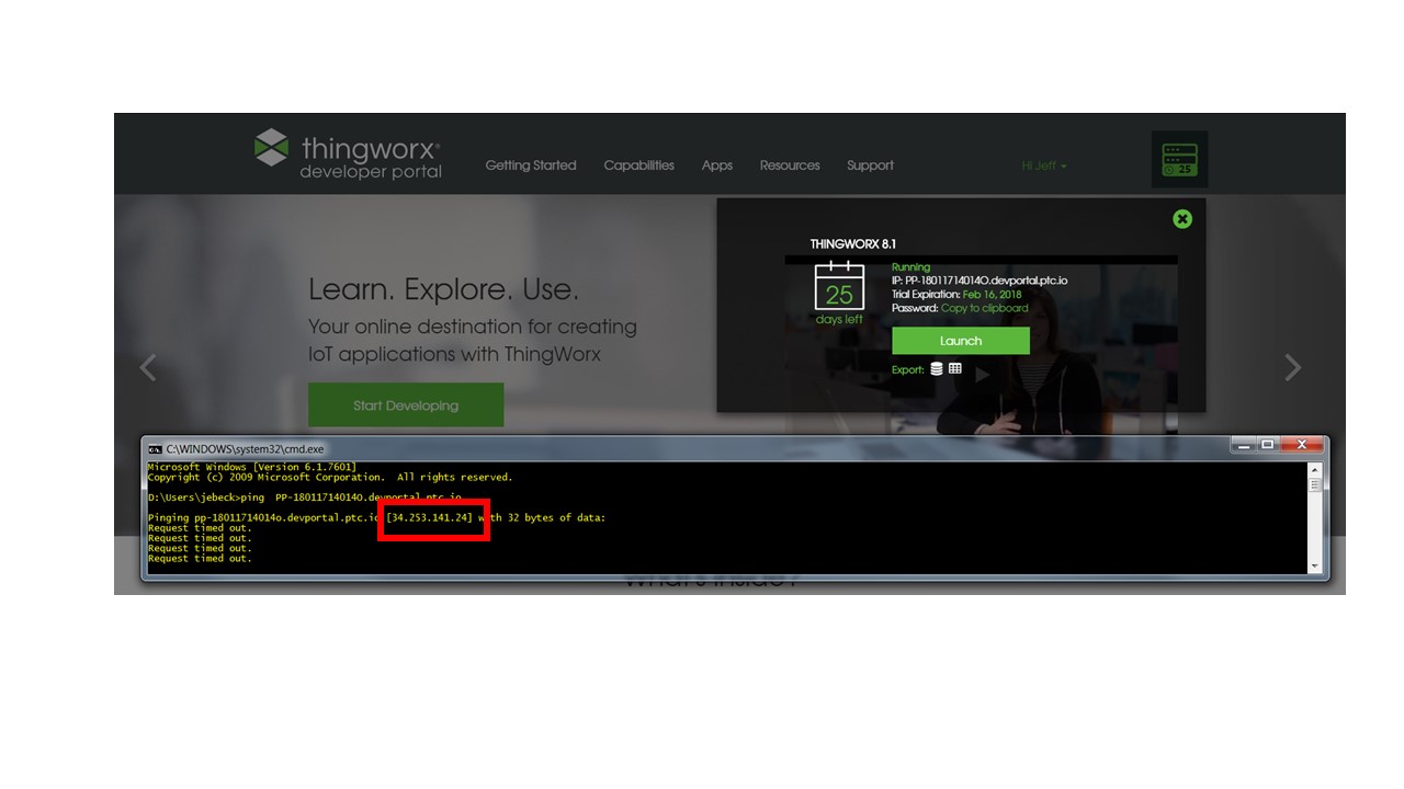

Jan 22, 2018 3:54 PM UTC
If it is a "hosted" trial server from the Developer Portal, try doing a ping on the ip address (i.e. PP-18011714014O.devportal.ptc.io).
