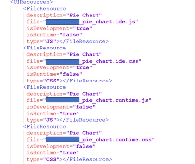

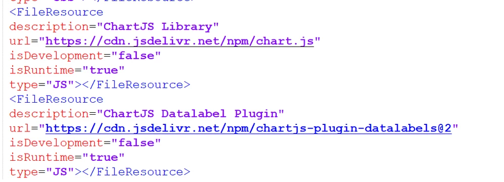

You can mention external javascript reference in the metadata.xml file

You can mention custom js like this.

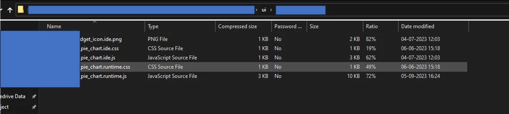

Place your files under folder ui > WIDGET NAME >
/VR
Nov 8, 2023 9:37 PM UTC
And to add to what @Velkumar stated, which is exactly what you need, you don't need to add in your runtime.js any import statement like the one you mentioned.
