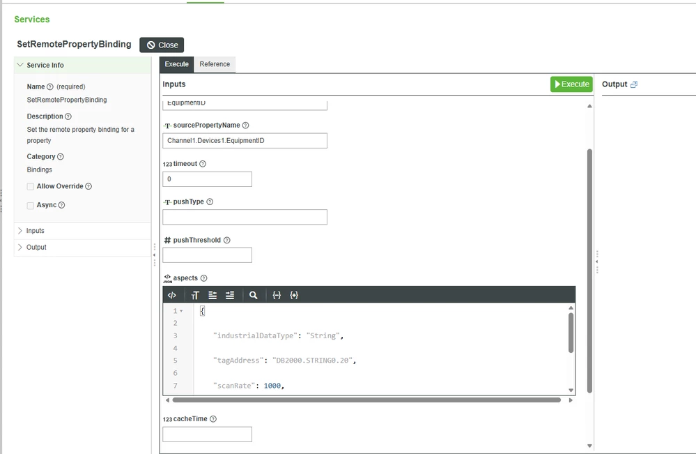

Hi All,
I've created an Industrial Thing with a Kepware connection. I want to create an application where adding and binding properties will be done from code without using Composer.
I tried to connect the ready properties with remote bind using the service SetRemotePropertyBinding
JK_10565232_0-1762511972802.pngWithout success.

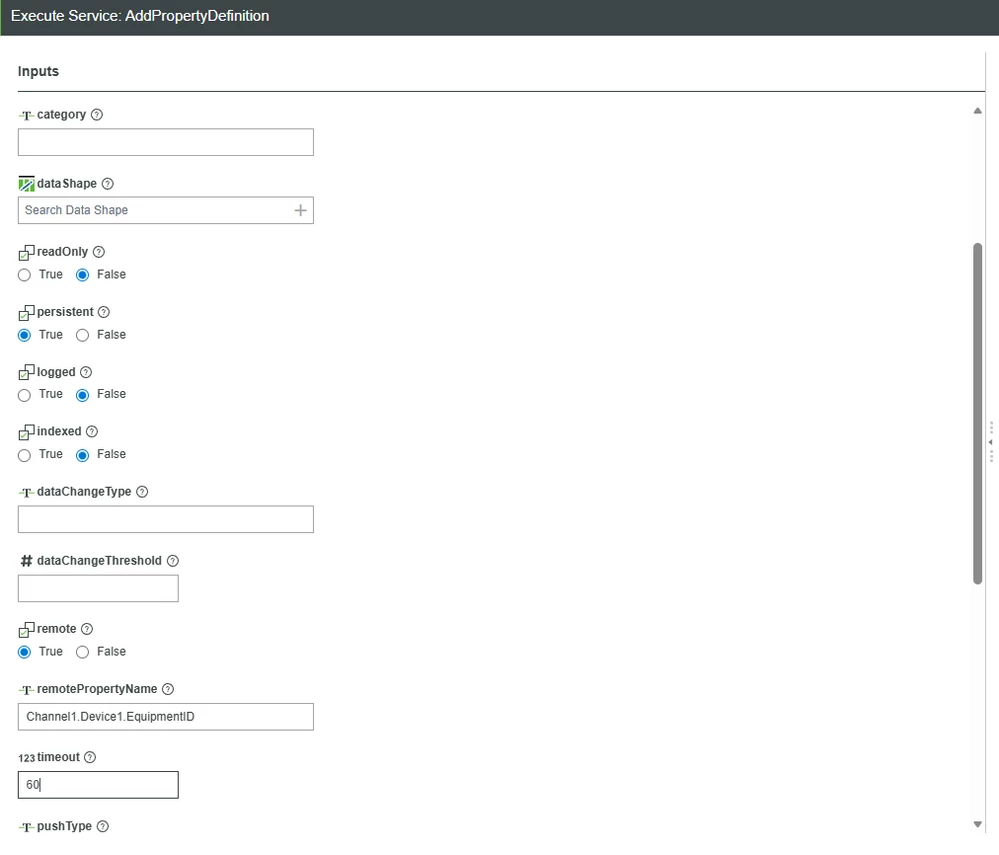

I tried to create a new property using AddPropertyDefinition and it also didn't work.
my aspcect json looks like that :
"industrialDataType": "String",
"tagAddress": "DB2000.STRING0.20",
"scanRate": 1000,
"tagType": "Static",
"readOnly": "true"
Where I did something wrong?

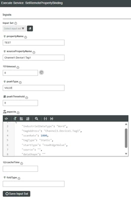

I tried following.. It's working fine.
The Kepware tag path is "Channel1.Device1.Tag1"
  1. Created Thing Property called "TEST" as STRING base type.
  2. Executed "SetRemotePropertyBinding()" service and passed following parameters.
     "propertyName": "TEST",
     "sourcePropertyName": "Channel1.Device1.Tag1",
     "timeout": "0",
     "pushType": "VALUE",
     "pushThreshold": "0",
     "aspects": {
     "industrialDataType": "Word",
     "tagAddress": "Channel1.Device1.Tag1",
     "scanRate": 1000,
     "startType": "readEdgeValue",
     "source": "",
     "dataShape": ""
6 replies

Nov 10, 2025 8:29 PM UTC
Hello Sathishkumar_C
Thank you for your answer. What kind of TW version are you using?
Nov 12, 2025 7:54 AM UTC
I tried it in 10.0.1
