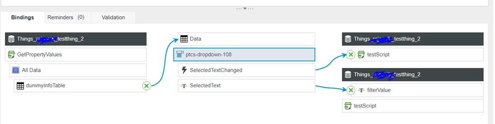

Hi all,
I want to use dropdown widget as a data filter for my grid advanced widget data for that I created a Thing then an infotable property and a service to call that info table property and now in my mashup I added a grid widget and bind this service to grid data now I want to filter my data based on some criteria by using dropdown widget so how can I bind it like I tried to bind the same service all data property to the data property of dropdown and then in dispaly option of dropdown I selected the filter option  but I am not getting the result please help me how  I can bind properly or if any other way to filter the data

Nov 11, 2023 12:01 AM UTC
Hi @Rayon_11
Could you please tell me from where you are getting data for Grid?
Based on your use case, you need to create a custom service with a query to filter InfoTable Data.
In my example, I'm trying to filter InfoTable Property. Please find below code for reference
let result = me.dummyInfoTable; // DUMMY DATA
if (filterValue && filterValue.length > 0) {
	// Provide your filter using the format as described in the help topic "Query Parameter for Query Services"
	let query = {
		"filters": {
			"type": "And",
			"filters": [{
				"fieldName": "name",
				"type": "EQ",
				"value": filterValue // INPUT PARAMETER
	let params = {
		t: me.dummyInfoTable /* INFOTABLE */ ,
		query: query /* QUERY */
	// result: INFOTABLE
	result = Resources["InfoTableFunctions"].Query(params);
Mashup Bindings
/VR
