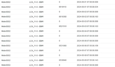

how can i delete data in infotable
I want to delete data in the infotable by checking from the _time field. If there are any duplicate time periods, check from the day, month, year. Then delete rows that have a value of 0 from the infotable. What methods can be used to do this?

Loop over the existing Infotable and create a new one containing only the required rows.
roughly like this (probably some syntax errors in it, but you'll get the idea):
let dateArray=[];
let oldTableArray=oldTable.rows.toArray();
// first pass: add non zero values, store dates in array
oldTableArray.filter(row=>row.value!=0).forEach(row=>{
   newTable.AddRow(row);
   dateArray.push(row._time.substring(0, 10));
// second pass: add zeroes if date not already contained in array built in first pass
oldTableArray.filter(row=>row.value==0 && !dateArray.includes(row._time.substring(0,10))).forEach(row=>{

Now, I have succeeded by using the method of looping through the infotable to check the data.
